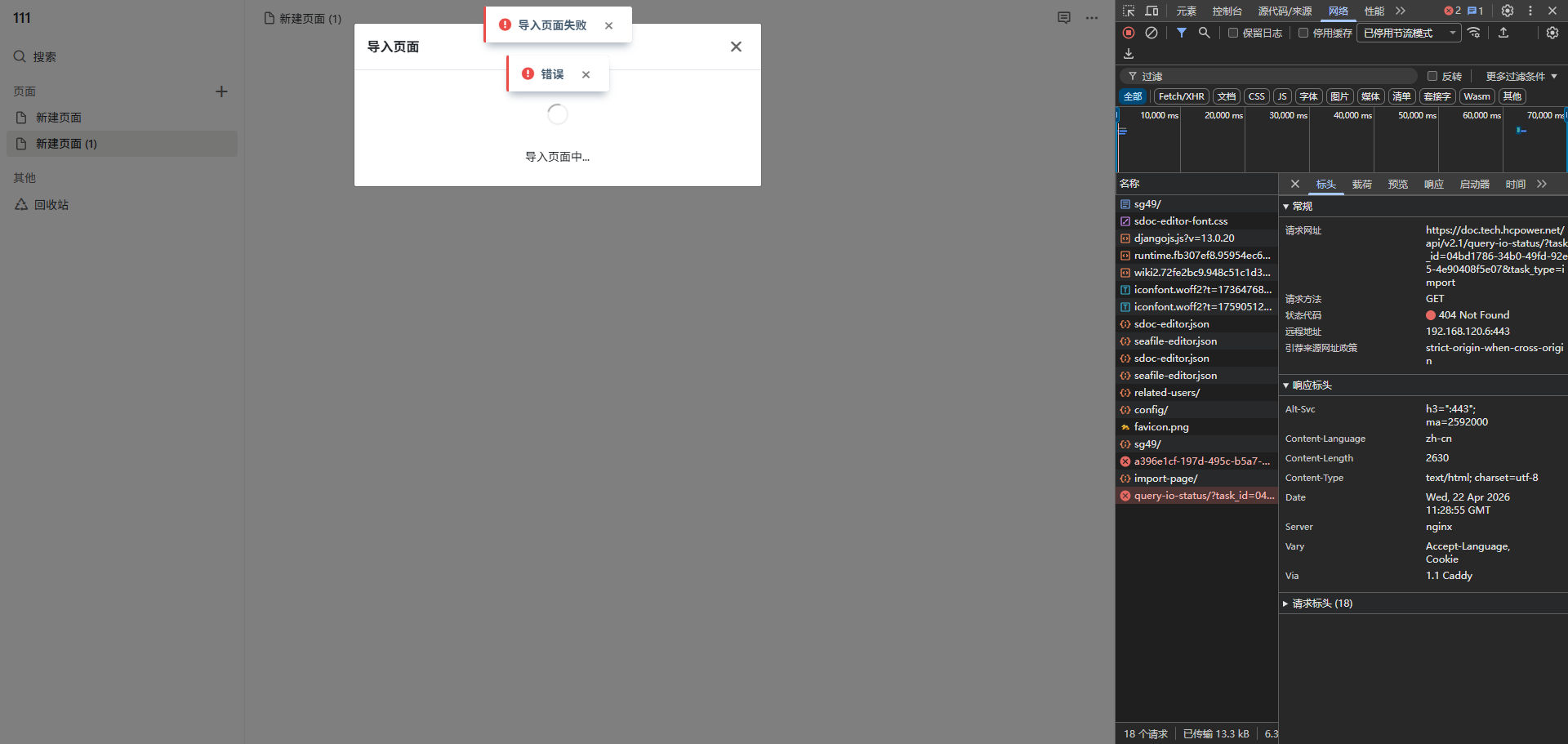

正常官方文档docker-compose部署,内网域名+公网域名ports+IP:8880,映射了seafile到8880端口,caddy-proxy labels管理手动证书(内网域名),证书通过certimate管理
错误截图
萌新只能发一张图,见下图

[2026-04-23 14:57:57] [WARNING] django.request:253 log_response Forbidden: /api/v2.1/seadoc/notifications/e13fd509-5c66-4e5b-9450-effa6bfa69df/
[2026-04-23 14:58:09] [WARNING] django.request:253 log_response Not Found: /sdoc-server
[2026-04-23 14:58:10] [WARNING] django.request:253 log_response Not Found: /favicon.ico
[2026-04-23 15:12:03] [WARNING] django.request:253 log_response Not Found: /sdoc-server/
[2026-04-23 15:12:47] [WARNING] django.request:253 log_response Not Found: /api/v2.1/query-io-status/
[2026-04-23 15:12:47] [WARNING] django.request:253 log_response Forbidden: /api/v2.1/seadoc/upload-image/09464da9-d8a6-4083-bbd0-e2dd176a85a0/
[2026-04-23 15:14:57] [WARNING] django.request:253 log_response Not Found: /api/v2.1/query-io-status/
[2026-04-23 15:14:57] [WARNING] django.request:253 log_response Forbidden: /api/v2.1/seadoc/upload-image/57816241-07ad-4325-998f-441cdd68609c/
[2026-04-23 15:20:24] [WARNING] django.request:253 log_response Not Found: /api/v2.1/query-io-status/
[2026-04-23 15:20:24] [WARNING] django.request:253 log_response Forbidden: /api/v2.1/seadoc/upload-image/e8164996-123b-46d7-ae11-aa411cc348e2/
[2026-04-23 15:20:25] [WARNING] django.request:253 log_response Forbidden: /api/v2.1/seadoc/upload-image/e8164996-123b-46d7-ae11-aa411cc348e2/
[2026-04-23 15:23:02] [WARNING] django.request:253 log_response Not Found: /api/v2.1/ping/
[2026-04-23 15:23:04] [WARNING] django.request:253 log_response Not Found: /api/v2.1/ping/
[2026-04-23 15:23:04] [WARNING] django.request:253 log_response Not Found: /favicon.ico
[2026-04-23 15:25:35] [WARNING] django.request:253 log_response Not Found: /api/v2.1/query-io-status/
[2026-04-23 15:25:38] [WARNING] django.request:253 log_response Not Found: /api/v2.1/query-io-status/
[2026-04-23 15:34:16] [WARNING] django.request:253 log_response Not Found: /v2.1/ping/
[2026-04-23 15:50:45] [WARNING] django.request:253 log_response Not Found: /api/v2.1/query-io-status/
[2026-04-23 15:50:45] [WARNING] django.request:253 log_response Forbidden: /api/v2.1/seadoc/upload-image/60d01b9e-6c36-43bb-a022-014fd42d1838/
[2026-04-23 15:51:15] [WARNING] django.request:253 log_response Forbidden: /api/v2.1/seadoc/notifications/e13fd509-5c66-4e5b-9450-effa6bfa69df/
[2026-04-23 15:51:19] [WARNING] django.request:253 log_response Forbidden: /api/v2.1/seadoc/notifications/d5bfed07-e46c-4376-9922-cea4c660d7ca/
[2026-04-23 15:51:21] [WARNING] django.request:253 log_response Forbidden: /api/v2.1/seadoc/notifications/a05f8b1c-e508-447d-998f-1aec6d3905db/
[2026-04-23 15:51:28] [WARNING] django.request:253 log_response Not Found: /api/v2.1/query-io-status/
[2026-04-23 15:51:34] [WARNING] django.request:253 log_response Forbidden: /api/v2.1/seadoc/notifications/a05f8b1c-e508-447d-998f-1aec6d3905db/
[2026-04-23 15:59:02] [WARNING] django.request:253 log_response Forbidden: /api/v2.1/seadoc/notifications/a05f8b1c-e508-447d-998f-1aec6d3905db/
[2026-04-23 15:59:21] [WARNING] django.request:253 log_response Not Found: /api/v2.1/query-io-status/
[2026-04-23 15:59:38] [WARNING] django.request:253 log_response Not Found: /api/v2.1/query-io-status/
[2026-04-23 15:59:38] [WARNING] django.request:253 log_response Forbidden: /api/v2.1/seadoc/upload-image/f17ef983-186a-4419-a872-c739fa200ddb/
[2026-04-23 15:59:39] [WARNING] django.request:253 log_response Forbidden: /api/v2.1/seadoc/upload-image/f17ef983-186a-4419-a872-c739fa200ddb/
[2026-04-23 16:12:44] [WARNING] django.request:253 log_response Forbidden: /api/v2.1/seadoc/notifications/a05f8b1c-e508-447d-998f-1aec6d3905db/
[2026-04-23 16:28:18] [WARNING] django.request:253 log_response Forbidden: /api/v2.1/seadoc/notifications/a05f8b1c-e508-447d-998f-1aec6d3905db/
[2026-04-23 16:29:15] [WARNING] django.request:253 log_response Not Found: /api/v2.1/query-io-status/
[2026-04-23 16:29:15] [WARNING] django.request:253 log_response Forbidden: /api/v2.1/seadoc/upload-image/18ba28b9-d418-4f3f-9212-3f77e8fbac18/
[2026-04-23 16:29:27] [WARNING] django.request:253 log_response Not Found: /api/v2.1/query-io-status/
报错日志如上
已升级最新版13.0.21
这是目前已知的一个 bug,我们会在下个版本修复该问题。
界面上虽然出现报错,wiki 其实已经导入成功了,您只要刷新一下就有了。
