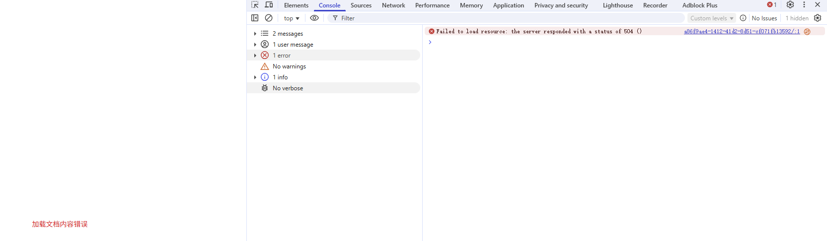

这样部署打开网站后,新建seadoc,然后点开等了很久出现文档加载错误
有知道是什么问题,要怎么解决的大师吗
可以F12看下网络请求有什么报错,同时也看下seadoc的日志中有什么错误
浏览器F12报错 504 {message: ‘Request failed with status code 504’, name: ‘AxiosError’, code: ‘ERR_BAD_RESPONSE’, config: {…}, request: XMLHttpRequest, …}

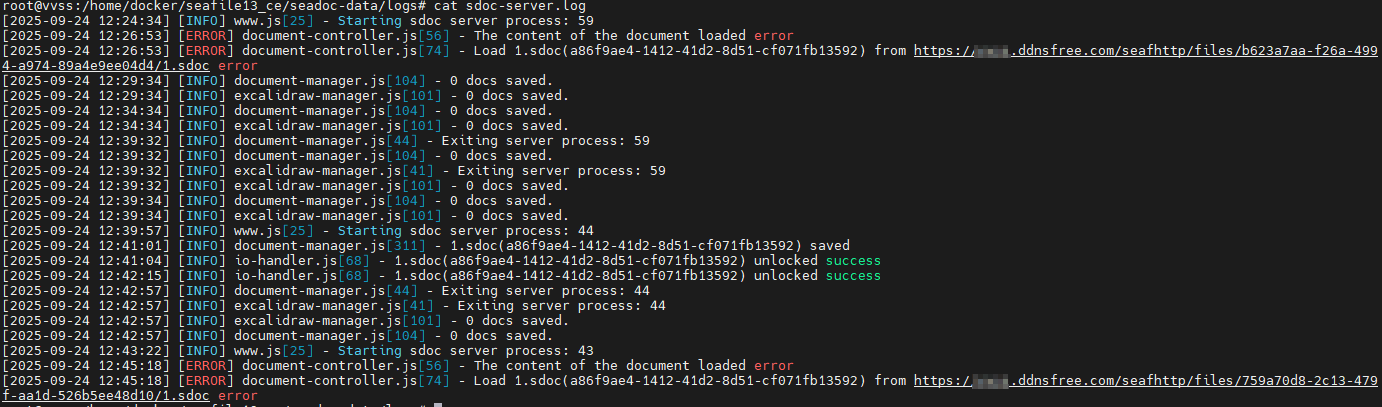

seadoc的日志里 56,74 报错:
[2025-09-24 12:24:34] [INFO] www.js[25] - Starting sdoc server process: 59
[2025-09-24 12:26:53] [ERROR] document-controller.js[56] - The content of the document loaded error
[2025-09-24 12:26:53] [ERROR] document-controller.js[74] - Load 1.sdoc(a86f9ae4-1412-41d2-8d51-cf071fb13592) from https://xxxx.ddnsfree.com/seafhttp/files/b623a7aa-f26a-4994-a974-89a4e9ee04d4/1.sdoc error
[2025-09-24 12:29:34] [INFO] document-manager.js[104] - 0 docs saved.
[2025-09-24 12:29:34] [INFO] excalidraw-manager.js[101] - 0 docs saved.
然后在.env里面把下面两行改回http和本地ip地址再重启docker就又能访问seadoc了
SEAFILE_SERVER_HOSTNAME=192.168.1.88
SEAFILE_SERVER_PROTOCOL=http
如图中间出现success因为把地址改回http了,若再改回https就又打不开了。
