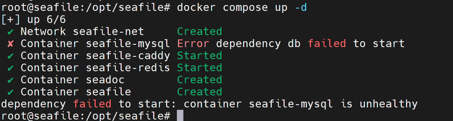

docker 部署社区版Seafile CE 13.0 启动失败
当前服务器版本
服务器操作系统:Ubuntu 22.04.5 LTS
使用docker 部署,启动seafile-mysql 容器失败,报错:Error dependency db failed to start
错误截图
错误日志
docker compose 日志完整输出如下:
root@seafile:/opt/seafile# docker compose logs --follow

浏览器控制台错误信息(如果相关,请提供截图信息)
使用 docker exec 命令进入 seafile-mysql 容器后,使用 .env 中设置的root 密码可以登陆 mariadb。

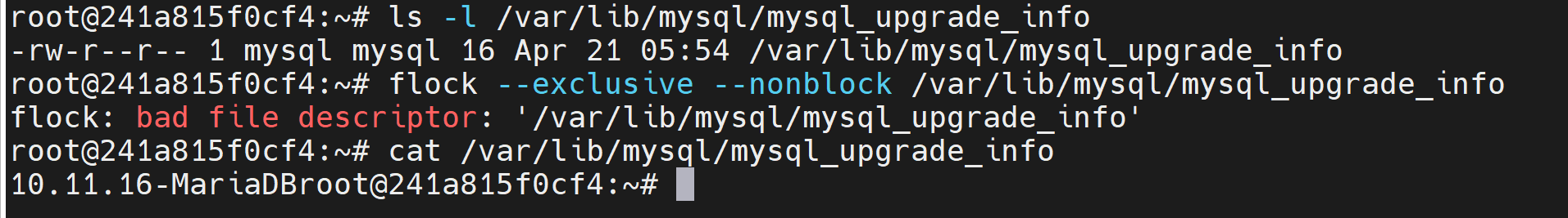

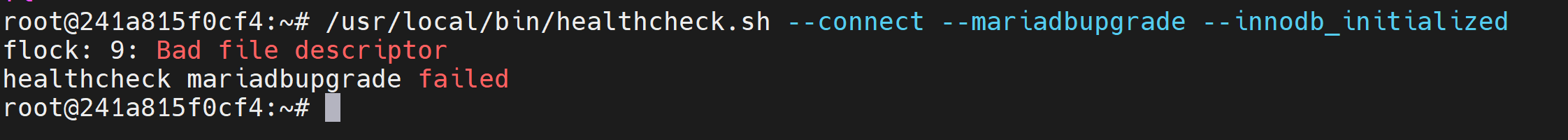

手动执行check脚本报错:
直接执行脚本中的flock 命令报错:

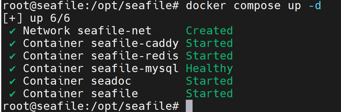

修改seafile-server.yml,临时跳过db的healthcheck,再次启动docker compose
docker compose logs --follow 日志显示启动成功:
seafile        | [2026-04-21 10:42:33] Updating version stamp
seafile        |
seafile        | Starting seafile server, please wait ...
seafile        | Seafile server started
seafile        |
seafile        | Done.
seafile        |
seafile        | Starting seahub at port 8000 ...
seafile        |
seafile        |
seafile        |
seafile        | ----------------------------------------
seafile        | Successfully created seafile admin
seafile        |
seafile        |
seafile        |
seafile        |
seafile        | Seahub is started
seafile        |
seafile        | Done.
seafile        |

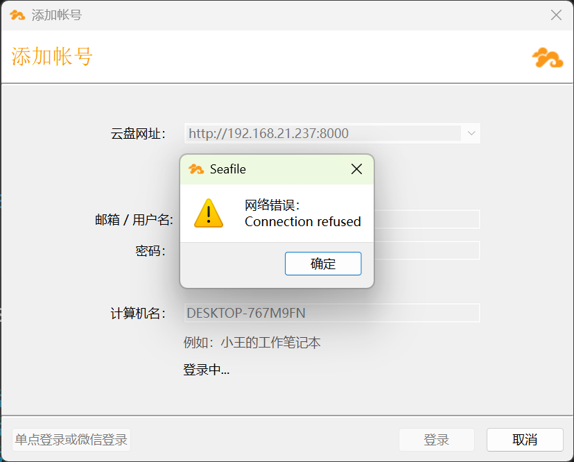

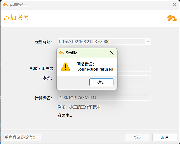

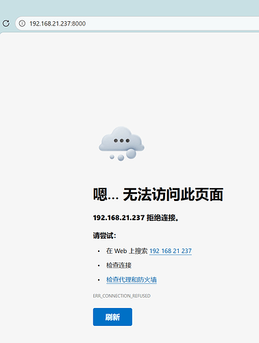

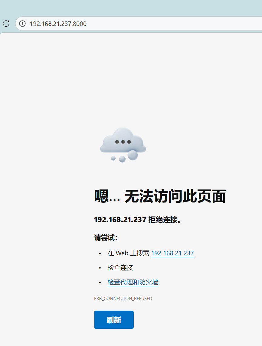

但是在Windows 上使用浏览器无法访问 http://192.168.21.237:8000

seafile-mysql  | 2026-04-21 10:42:06 0 [Note] mariadbd: ready for connections.
seafile-mysql  | Version: '10.11.16-MariaDB-ubu2204'  socket: '/run/mysqld/mysqld.sock'  port: 3306  mariadb.org binary distribution
seafile        | *** Running /etc/my_init.d/01_create_data_links.sh...
seadoc         | *** Running /etc/my_init.d/01_init.sh...
seadoc         | *** Booting runit daemon...
seadoc         | *** Runit started as PID 11
seadoc         | *** Running /scripts/enterpoint.sh...
seadoc         | 2026-04-21 10:42:11 Nginx ready
seadoc         | 2026-04-21 10:42:11 This is an idle script (infinite loop) to keep container running.
seafile-caddy  | {"level":"info","ts":1776768131.1823587,"logger":"docker-proxy","msg":"New Caddyfile","caddyfile":"http://seafile.guangzhou.lan {\n\thandle_path /socket.io/* {\n\t\trewrite * /socket.io{uri}\n\t\treverse_proxy 172.18.0.6:80\n\t}\n\thandle_path /sdoc-server/* {\n\t\trewrite * {uri}\n\t\treverse_proxy 172.18.0.6:80\n\t}\n\treverse_proxy 172.18.0.5:80\n}\n"}
seafile-caddy  | {"level":"info","ts":1776768131.182799,"logger":"docker-proxy","msg":"New Config JSON","json":"{\"apps\":{\"http\":{\"servers\":{\"srv0\":{\"listen\":[\":80\"],\"routes\":[{\"match\":[{\"host\":[\"seafile.guangzhou.lan\"]}],\"handle\":[{\"handler\":\"subroute\",\"routes\":[{\"group\":\"group2\",\"handle\":[{\"handler\":\"subroute\",\"routes\":[{\"handle\":[{\"handler\":\"rewrite\",\"strip_path_prefix\":\"/sdoc-server\"}]},{\"group\":\"group1\",\"handle\":[{\"handler\":\"rewrite\",\"uri\":\"{http.request.uri}\"}]},{\"handle\":[{\"handler\":\"reverse_proxy\",\"upstreams\":[{\"dial\":\"172.18.0.6:80\"}]}]}]}],\"match\":[{\"path\":[\"/sdoc-server/*\"]}]},{\"group\":\"group2\",\"handle\":[{\"handler\":\"subroute\",\"routes\":[{\"handle\":[{\"handler\":\"rewrite\",\"strip_path_prefix\":\"/socket.io\"}]},{\"group\":\"group0\",\"handle\":[{\"handler\":\"rewrite\",\"uri\":\"/socket.io{http.request.uri}\"}]},{\"handle\":[{\"handler\":\"reverse_proxy\",\"upstreams\":[{\"dial\":\"172.18.0.6:80\"}]}]}]}],\"match\":[{\"path\":[\"/socket.io/*\"]}]},{\"handle\":[{\"handler\":\"reverse_proxy\",\"upstreams\":[{\"dial\":\"172.18.0.5:80\"}]}]}]}],\"terminal\":true}]}}}}}"}
seafile-caddy  | {"level":"info","ts":1776768131.1828268,"logger":"docker-proxy","msg":"Sending configuration to","server":"localhost"}
seafile-caddy  | {"level":"info","ts":1776768131.1829708,"logger":"admin.api","msg":"received request","method":"POST","host":"localhost:2019","uri":"/load","remote_ip":"127.0.0.1","remote_port":"41140","headers":{"Accept-Encoding":["gzip"],"Content-Length":["964"],"Content-Type":["application/json"],"User-Agent":["Go-http-client/1.1"]}}
seafile-caddy  | {"level":"info","ts":1776768131.1835957,"logger":"admin","msg":"admin endpoint started","address":"localhost:2019","enforce_origin":false,"origins":["//localhost:2019","//[::1]:2019","//127.0.0.1:2019"]}
seafile-caddy  | {"level":"info","ts":1776768131.183969,"logger":"tls.cache.maintenance","msg":"started background certificate maintenance","cache":"0xc0001ebd00"}
seafile-caddy  | {"level":"warn","ts":1776768131.1840677,"logger":"http.auto_https","msg":"server is listening only on the HTTP port, so no automatic HTTPS will be applied to this server","server_name":"srv0","http_port":80}
seafile-caddy  | {"level":"warn","ts":1776768131.1855898,"logger":"http","msg":"HTTP/2 skipped because it requires TLS","network":"tcp","addr":":80"}
seafile-caddy  | {"level":"warn","ts":1776768131.1855998,"logger":"http","msg":"HTTP/3 skipped because it requires TLS","network":"tcp","addr":":80"}
seafile-caddy  | {"level":"info","ts":1776768131.1856017,"logger":"http.log","msg":"server running","name":"srv0","protocols":["h1","h2","h3"]}
seafile-caddy  | {"level":"info","ts":1776768131.1861854,"msg":"autosaved config (load with --resume flag)","file":"/config/caddy/autosave.json"}
seafile-caddy  | {"level":"info","ts":1776768131.1861947,"logger":"admin.api","msg":"load complete"}
seafile-caddy  | {"level":"info","ts":1776768131.1862838,"logger":"docker-proxy","msg":"Successfully configured","server":"localhost"}
seafile-caddy  | {"level":"info","ts":1776768131.1884298,"logger":"admin","msg":"stopped previous server","address":"localhost:2019"}
seafile-caddy  | {"level":"info","ts":1776768131.1896021,"logger":"tls","msg":"storage cleaning happened too recently; skipping for now","storage":"FileStorage:/data/caddy","instance":"3a4acb38-1823-478d-afc4-5ab082e0621a","try_again":1776854531.189597,"try_again_in":86399.9999997}
seafile-caddy  | {"level":"info","ts":1776768131.189644,"logger":"tls","msg":"finished cleaning storage units"}
seafile        | *** Booting runit daemon...
seafile        | *** Runit started as PID 11
seafile        | *** Running /scripts/enterpoint.sh...
seafile        | 2026-04-21 10:42:11 Nginx ready
seafile        | nginx: [warn] conflicting server name "" on 0.0.0.0:80, ignored
seafile        | 2026-04-21 10:42:11 This is an idle script (infinite loop) to keep container running.
seafile-mysql  | 2026-04-21 10:42:11 3 [Warning] Access denied for user 'seafile'@'172.18.0.5' (using password: YES)
seafile        | [2026-04-21 10:42:11] Now running setup-seafile-mysql.py in auto mode.
seafile        | Checking python on this machine ...
seafile        |
seadoc         | sdoc-server started
seadoc         |
seadoc         | [2026-04-21 10:42:12] Start Monitor
seadoc         | server is serve on http://127.0.0.1:7070
seafile        |
seafile        | verifying password of user root ...  done
seafile        |
seafile        | This is your configuration
seafile        |
seafile        |     server name:            seafile
seafile        |     server ip/domain:       seafile.guangzhou.lan
seafile        |
seafile        |     seafile data dir:       /opt/seafile/seafile-data
seafile        |     fileserver port:        8082
seafile        |
seafile        |     database:               create new
seafile        |     ccnet database:         ccnet_db
seafile        |     seafile database:       seafile_db
seafile        |     seahub database:        seahub_db
seafile        |     database user:          seafile
seafile        |
seafile        |
seafile        | Generating seafile configuration ...
seafile        |
seafile        | done
seafile        | Generating seahub configuration ...
seafile        |
seafile        | Now creating seafevents database tables ...
seafile        |
seafile        | Now creating ccnet database tables ...
seafile        |
seafile        | Now creating seafile database tables ...
seafile        |
seafile        | Now creating seahub database tables ...
seafile        |
seafile        |
seafile        | creating seafile-server-latest symbolic link ...  done
seafile        |
seafile        |
seafile        |
seafile        |
seafile        | -----------------------------------------------------------------
seafile        | Your seafile server configuration has been finished successfully.
seafile        |
seafile        | run seafile server:     ./seafile.sh { start | stop | restart }
seafile        | run seahub  server:     ./seahub.sh  { start <port> | stop | restart <port> }
seafile        |
seafile        | If you are behind a firewall, remember to allow input/output of these tcp ports:
seafile        |
seafile        | port of seafile fileserver:   8082
seafile        | port of seahub:               8000
seafile        |
seafile        | When problems occur, Refer to
seafile        |
seafile        |         https://download.seafile.com/published/seafile-manual/home.md
seafile        |
seafile        | for information.
seafile        |
seafile        |
seafile        |
seafile        |
seafile        | Done.
seafile        |
seafile        |
seafile        |
seafile        |
seafile        |
seafile        |
seafile        |
seafile        |
seafile        |
seafile        | Done.
seafile        |
使用Windows 客户端添加账号报 网络连接被拒绝 错误。
使用Windows 命令行ping seafile 服务器IP 可以ping 通

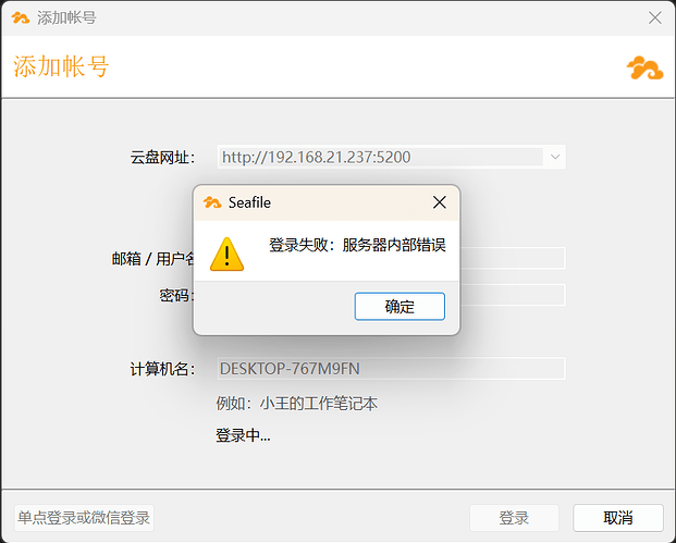

我看你这边没有使用标准的 80 端口。
修改标准端口参考下面的方法:
1.修改 caddy.yml
  caddy:
    restart: unless-stopped
    container_name: seafile-caddy
      - 80:80
      - 5200:5200(这里修改为你的端口)
2.修改 env 文件
## Scheme
SEAFILE_SERVER_HOSTNAME=你的域名:你的非标准端口
SEAFILE_SERVER_PROTOCOL=http
最后清空数据后重启服务。
你好,我更改 .env 和 caddy.yml 后,运行 docker compose downdocker compose up -d 重启服务后访问失败。
.env 部分配置如下:
SEAFILE_SERVER_HOSTNAME=seafile.guangzhou.lan:5200
caddy.yml 配置如下:
caddy:
image: ${SEAFILE_CADDY_IMAGE:-lucaslorentz/caddy-docker-proxy:2.12-alpine}
  • 80:80
  • 5200:5200
  • CADDY_INGRESS_NETWORKS=seafile-net
  • /var/run/docker.sock:/var/run/docker.sock
  • ${SEAFILE_CADDY_VOLUME:-/opt/seafile-caddy}:/data/caddy
    networks:
  • seafile-net
    healthcheck:
    test: [“CMD-SHELL”, “curl --fail http://localhost:2019/metrics || exit 1”]
    start_period: 20s
    interval: 20s
    timeout: 5s
    retries: 3
networks:
seafile-net:

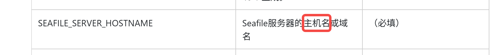

seafile 服务器主机名:
root@seafile:~# hostname
客户端添加账号报登陆失败
完整的 docker compose logs -f 输出如下:

你好,能帮忙看下吗?部署了2次,12.0 和 13.0 两个版本都试了,都是同样的问题。
您这里不是正规域名吧,如果没有正规域名,就只能配置 ip 地址和 http 协议。
如果有域名,才能配置域名 :plus: https 协议。
你好,seafile.guangzhou.lan 是主机名,我看 部署社区版 文档上要写主机名
主机名指的是正规域名或者 IP 地址。
如果您有正规域名,就配置域名 + https 协议。
如果没有域名,就配置 ip + http 协议。
1 个赞
