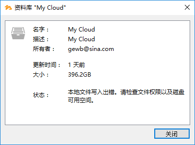

外网连接的客户端和另外一台电脑内网连接的客户端都没问题,这台电脑将本机的原有的资料目录与服务端重新同步时出现错误:
日志文件applet.log:

日志文件seafile.log:
[07/06/17 18:43:59] bad signature
[07/06/17 18:43:59] index file corrupt
[07/06/17 18:43:59] repo-mgr.c(6108): Failed to load index.
[07/06/17 18:43:59] http-tx-mgr.c(1132): Transfer repo ‘85afb2a2’: (‘normal’, ‘data’) → (‘error’, ‘finished’)
[07/06/17 18:43:59] clone-mgr.c(857): Transition clone state for 85afb2a2 from [fetch] to [error]: fetch.
[07/06/17 18:44:00] clone-mgr.c(840): Transition clone state for 85afb2a2 from [error] to [check server].
[07/06/17 18:44:00] http-tx-mgr.c(1236): Bad response code for GET http://10.0.0.199:8000/seafhttp/protocol-version: 404.
[07/06/17 18:44:00] [07/06/17 18:44:00] clone-mgr.c(840): Transition clone state for 85afb2a2 from [check server] to [fetch].
http-tx-mgr.c(4285): Download with HTTP sync protocol version 1.
[07/06/17 18:44:00] http-tx-mgr.c(1132): Transfer repo ‘85afb2a2’: (‘normal’, ‘init’) → (‘normal’, ‘check’)
[07/06/17 18:44:00] http-tx-mgr.c(1132): Transfer repo ‘85afb2a2’: (‘normal’, ‘check’) → (‘normal’, ‘commit’)
[07/06/17 18:44:00] http-tx-mgr.c(1132): Transfer repo ‘85afb2a2’: (‘normal’, ‘commit’) → (‘normal’, ‘fs’)
请教各位大侠如何解决
